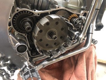

Hi All,

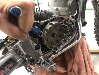

Im stumped - need help. This is the problem: After a recent rebuild - engine turns over on crank fine - see pic 1. All the gears turn - the crank gear the flywheel gear the clutch basket and the kickstart gears - all turn when I turn the engine, Pic 2 - when I try the kick start its solid! When I slide the clutch basket off the kickstart and starter cog turn fine and return spring - everything. Then when the clutch basket goes back on - solid with the kickstart! What is going on? Any help appreciated...Attachment 9130 Attachment 9131 |
Do the crank, clutch and balancer rotate ok without the kickstart assembly in place?
yes all rotate normally on the crank
The kick start drive is not "timed " properly.
There's a flat plate that the kick lever gear ramps on, to engage the clutch basket gear. You can try rotating the kick start gear clockwise a couple degrees. |
Assembly should be the same as listed in this manual.
https://www.dropbox.com/s/i93vw77r9k...anual.pdf?dl=0 |
Quote:
I've had the same before, with mine it was the little nylon spacer for the spring had indexed round so the cutout wasn't mating with the spring
