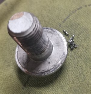

Snapped off both left and right upper footpeg bracket bolts on hard mx landings. Had to drill them out and replace them. Drilled out the threads in the frame and mounted a longer bolt and a nut on the opoosite side.
