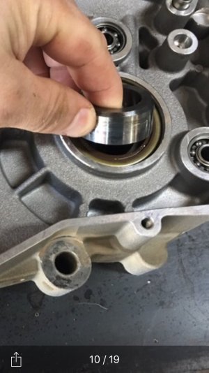

I installed a Lectron carb last week in hopes of this problem going away but it is still smokes the same. Could it be the right side crank seal? The bike runs strong otherwise. I plan on replacing this bike within the next two years so I don’t really want to split the cases and do a complete rebuild. Has anyone had luck with replacing the seal without splitting the cases? It looks like there is an inner bushing which could be removed first and then pull the seal out. (I’ve hijacked a picture RockefellerGG’s rebuild thread that shows the bushing) IMG_8686.JPG Sent from my iPhone using Tapatalk |

It's very easy to do, make sure you oil the inner surface of the seal before you put it in or it will burn out quickly

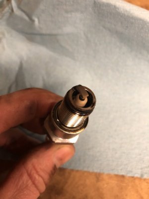

I thought that it could have been loading up and that was my excuse to buy a Lectron for the bike. Plug looks very clean after my first ride with the new carb. To be honest, I never had a plug look as clean as this one does. I think I’ll try the seal anyways. It looks fairly easy to do because of the bushing that can be removed first. I was never a fan of drilling a screw into the seal and risk getting some chips in the bearing IMG_8680.JPG Sent from my iPhone using Tapatalk |
