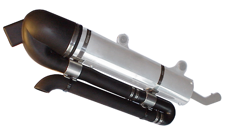

I don't know about sound. In reality, these V-twins are a whole lot louder than two strokes. I have a FMF Q made for a ktm 300, and it killed all my top end, so I took the sparky out and made it straight through. It's still kind of quiet, but there isn't too quiet. There's a thing out there caled a DB-snorkel, supposed to be real quiet, but also, real odd looking, like a big rubber V-8 can with a rubber tube.

http://www.thedbsnorkel.com
Skidad in MA

I have the dbsnorkel on my 300. It helps a bit. More so when you're on the pipe than at tech. inspection I think. I think I was 91db at the last legit. test I took.
