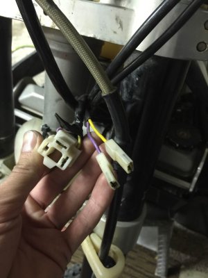

I bought the bike used, with just a plastic number plate and no headlight. I plugged in a halogen headlight and it didn't work. I thought that perhaps the other wires were for a handlebar switch and that they needed to be connected to complete the circuit. Still no success so I got out the multimeter. When the two individuals were connected I went from no volts at the headlight plug to 1 volt. What am I missing?

Your volt meter has to be set on "ac".

Oh yeah, of course. I'll try again and report back. Are those two individual plugs made for a handlebar switch? Any idea why the light wouldn't work?

Turned out the bulb I was testing with had one beam burned out. I just mounted an LED light bar and now I'm trying to wire in a DC reg/rectifier, but I don't have a white wire coming out of the stator. I posted more details in the DC sticky at the top.
