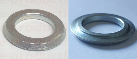

Question Rear Wheel Bearings Spacer - sprocket side - EC300 (2006)
Part No. BE250318056 superceded by BE555012509

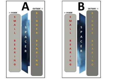

Which way should it be installed - A or B ? (see attachments)
File Type: jpg rear-wheel-bearings-spacer-fitment-c.jpg (13.0 KB, 20 views)
Old 08-29-2021, 07:13 PM
gasgasman's Avatar
gasgasman gasgasman is offline
Location: Pearland Texas
Posts: 4,598
A
I also use the axle to keep the spacer aligned when installing the outer bearing.

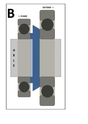

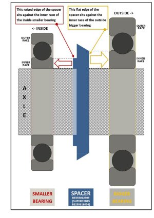

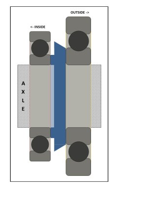

I'm not convinced it is A for this spacer (BE555012509) which supercedes BE250318056. I've had a closer look and drawn it more to scale as per attachments. Seems to me like it B is the correct fitment?

Old 09-01-2021, 06:45 AM
cbutler's Avatar
cbutler cbutler is offline
Join Date: Mar 2009
Location: Hot Springs AR
Posts: 709
http://www.gasgasrider.org/forum/showthread.php?t=2566
First post has pic of how it goes.

Originally Posted by cbutler View Post
That post refers to the old spacer BE250318056 which has been superceded by this new one BE555012509. They are very different.

Old 09-02-2021, 04:58 AM
Gasser Nate's Avatar
Gasser Nate Gasser Nate is offline
Join Date: May 2010
Posts: 644
Have a close look at the spacer, it will have a step on it that ensures the torque of the axle nut only puts pressure on the bearing centre and not the seal/case area. A in the diagram above is correct.

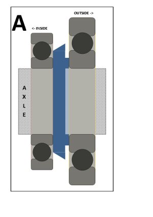

I totally understand the "putting torque pressure on the wrong part of the bearing" thing which is why I asked the question.
I think I caused confusion because the drawings I put in the original post are not to scale, so sorry for that. I've now attached drawings of both A & B fitment which might help to resolve the question. To me B looks right, but would appreciate all your thoughts. Thanks.
Old 09-02-2021, 10:49 PM
Join Date: May 2010
Posts: 644
This one is correct.
